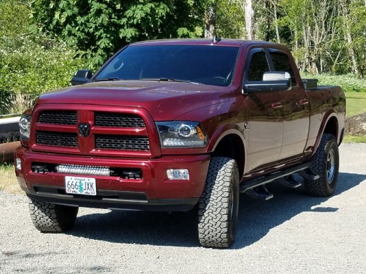

Would it be possible for you to post a couple of pics of your truck? I'm curious how the 18's look as well as the Nitto's. I'm trying to decide how I want to go with my setup, and most of the pics I'm seeing online are with 20x10's.

Here are some pics of my truck. 2" spacer level from Les Schwab, Walker Evans Racing Legacy 504 wheels (18x9, +12mm offset). If you are around Hillsboro or Beaverton area you can check out the level, wheels and tires in person if you want.

Considering that the stock 20 inch wheels that came on my truck have a +55mm offset, going to +12mm represents a 43mm negative change. That's 1.7" pushed towards the outside. I've got a bit over 1.25" of tire outside the wheelwell given the wheel negative offset change + the wider tires.
Do you have your stock wheels on your truck at this time?
Now the larger offsets, say the -25mm, moves the wheels outwards even more. That offset difference from stock is 80mm (55+25) or a little over 3". Go too far out, and load the truck to its' maximum payload and now you may have a problem keeping the center in the wheels. It could break out due to more weight at the wheel hub and a leverage point moved outwards from the strongest portion of the suspension. You are correct. The higher the negative offset number is, the farther outwards the wheel will be away from the body.
The ride suffers with lower profile tires on high negative offset wheels, which is I believe you were referring to.
A +12mm offset, with 9" wheel and 35x12.50R18 tires; is about as far as I want them wheels & tires pushed out. My wheels and tires are 34.76" tall (with new 35" tires), and I like having a taller tire for more sidewall. Going to a larger wheel (22" & up) limits how much tire sidewall height you can get and that's gonna be a rough ride.
20" wheels, with a LT285/60R20E tire, came standard on the 2500 trucks. Since I was going to push the wheels and tires outwards, I leveled for the look and to avoid rubbing on suspension or body parts.
In the case of a 1500 you can easily level the front of your truck using several methods, go with a small positive or small negative offset wheel and a set of 33" tires for a nice look. Not stuffed but no big gaps, either. If the bed is loaded to capacity and you have some sag, the best way to avoid rear tire and wheel rubbing is to add air bags in the back to level the truck.
