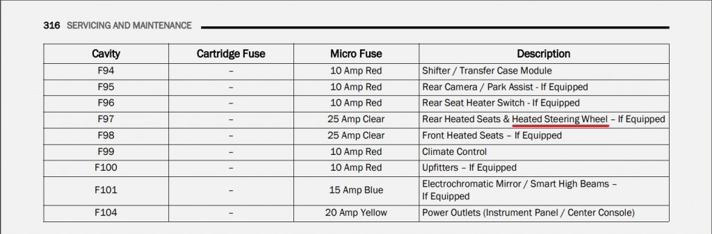

This is an excerpt from a PDF manual for my truck indicating the fuse for the heated steering wheel. Another quick & easy check is to locate and inspect/test the fuse.
I have not, but i will today and thanks for the help.
fuzes are good!
