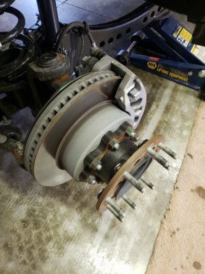

I can't stand how front hub sticks out, there is a spacer that converts 8x165 to 8x200mm so the wheels are interchangeable. I want to eliminate spacer and I'm try to find matching wheels with the correct bolt patterns and offset to make this happen.
Can any of you wheel experts assist?

Decide on the width of wheel you want and then pick the offset you want that places the outside of the rim where you want it and remember that if the tire is wider than the rim it will stick out that much further past the rims edge. Use an offset calculator on the internet to get all the geometry right.

I understand all that, need to find matching wheels with different specs Front/rear

@Customoffsets is where I'd start at. 1 they're a preferred vendor here and they have an amazing configuration tool and customer service is awesome
