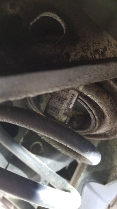

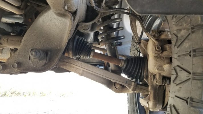

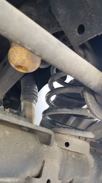

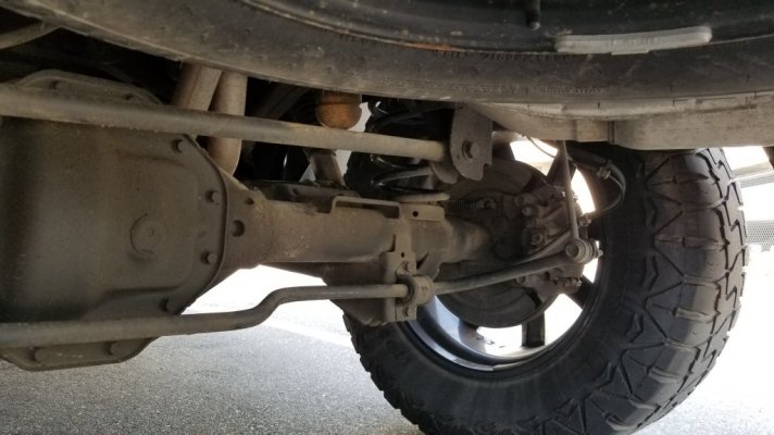

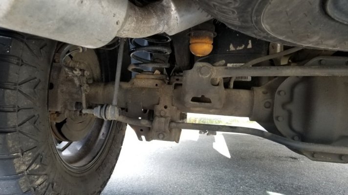

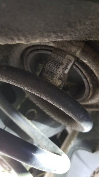

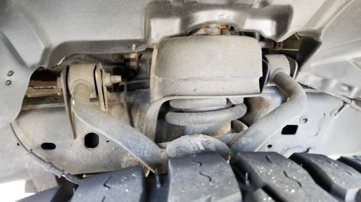

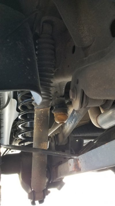

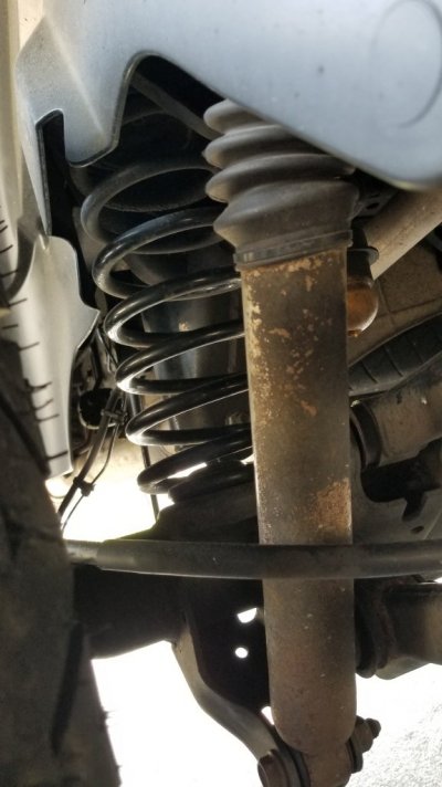

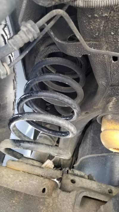

4) I'm not sure how to determine what I have for a lift. I took some pictures of my undercarriage, maybe some of you can help. The front shocks appear to be stock, but I don't know. I can't find any logos or info on the rear shocks. My biggest 2 questions are: how do I determine how much my truck is lifted, and how do I keep this look and amount of lift but make it ride and handle properly as a daily driver? I don't plan on really doing much off roading, I just love how it looks.

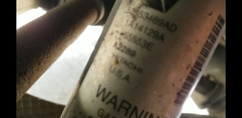

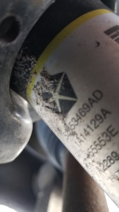

Thanks for any and all help, info, ideas, etc! The close-ups of the info on the shocks in the pictures are the front shocks (front passenger side specifically). I couldn't find much on the rear shocks.

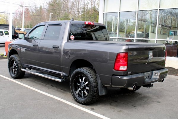

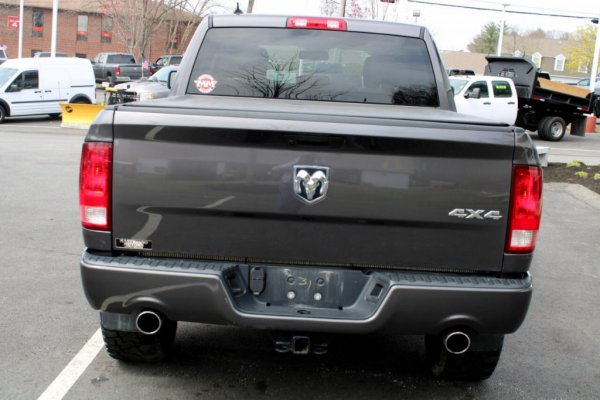

Adding pictures of the truck itself for reference. This is how it currently sits.

A couple of things I noticed. Your CV angles are very extreme. They should be almost flat, or have a slight bend to them. This is most likely causing you to be out of alignment. If you do not have enough positive caster it will drive like a shopping cart. Which is exactly the situation you described. You also probably have very little down travel left. My guess is no one who knew what they were doing has ever aligned your truck.
I would guess you have the Rough Country 3" Kit. A good swap out would be the Readylift 4" kit
A better track bar will certainly help the truck feel planted in the rear, but it should drive okay with the factory one.
Also 4th gen 1500's do not have a pitman arm as they are IFS. :cheers:

Measure ground to the edge of your fender front and rear. The angle of your CV axle is a little steep. and you already have aftemarket front UCA's, only couple of lifts come with those if the PO did buy as a kit. You may have alignment issues, shock issues, control arm issues CV axle issues, tire balance issues etc. First thing is to get a alignment report, and check all your bushings are good.
Thanks for the info! And I guess I haven't looked under my truck with enough detail to know about the pitman arm. Woops.
Is the only cure for the CV axel angles to drop the front diff? Does that end up killing ground clearance?
Why would you recommend swapping lifts, and why add another inch? What makes you say it's the Rough Country 3"?

Also, you say I probably have very little down travel left. Can you explain? Is this because of the shocks or the control arms? I would have thought that if they put taller springs in with stock shocks, which I what I think they did just judging from the branding on the shocks, I would think that would cause the shocks to be further extended at rest than stock, and for them to run out of extension over bumps. I'd guess that would cause the tires to come off the ground when the truck body goes over the bump. Am I way off? Is the only way to check this to remove the shocks and extend them?

How can you tell I have aftermarket front upper control arms? Is that good or bad? I have 35x12.50 tires. Just ordered a new set of KO2's for it.
If you look at your pic 080634 it shows a RC on the ball joint cap. RC is the logo for Rough Country. OEM UCAs are stamped steel and yours are forged. I don’t think you can use factory shocks with a 3 inch lift. You may have puck spacers to level the front end. Puck spacers reduce the range of suspension travel and will put your CV’s at an increased angle which your pics show.
Oh no ****, I didn't even notice the RC. Thank you for pointing that out! Do you happen to know if those are any good? The reason I think the shocks are stock is because of the Chrysler logo in the pictures of the front shocks. I couldn't find logos on the rears but they definitely don't look new, or fancy like I think most aftermarket suspension parts usually look.
Also, how can you tell it is a 3" lift? Thanks again for the info!
Based on the stance, CV angles, and Upper Control arms I assumed you had this kit
3" Rough Country Lift
But it appears this kit does not come with rear shocks, Which you do not have factory rear shocks. Factory ones will be black and have a smooth boot cover.
So most likely you have some cobbled together lift kit done by someone who didn't know what they were doing. (cobbled together lift kits aren't always a bad thing many of us here have that, however it should not be riding poor. These trucks tend to ride better than most lifted when done right.)
The first thing I would do is make whoever sold you the warranty do an alignment along with balancing your tires. (make them show you the printout.) also any tire shop worth their salt could balance 35's.
If they can do that it should at least drive straight at highway speeds.
However what you have going on is a recipe for disaster down the road. (in my opinion lol)
If I were in your shoes I would do 1 of 2 options.
If you like the lifted look go with the Readylift 4" lift kit - and have a good shop do the install. @Quick_Shifter is in PA and is by far the best ram suspension guy in the world.
If you're okay going down a tad I would do Bilstein 5100's at 2.8 along with some Bilstein Rear Coils
That would be similar to what you have now, and ride very well.
I hope some of this makes sense lol.
