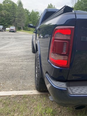

Thanks to this thread I am now running my 1/2” hub-centric slip on BORA spacers with plenty of thread engagement. The new ARP studs went in easily after letting them sit in the freezer overnight. Thanks for the info!
Wow, that looks almost exactly the same as my truck! Except the light bar in the lower grill opening. Although I would love to know more about that!
Glad it worked out for you.
