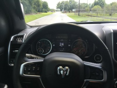

Hello all,
I am writing to ask other Ram owners if they experience a pull / drift to the right when lightly touching or taking their hands off the steering wheel for a few moments.
I have a 2019 Ram 1500 Laramie crew cab and I have a constant pull / drift to the right as soon as I let go of the steering wheel. Depending on road grade, the drift either starts out subtle and worsens or it can be severe enough to instantly start changing lanes or pull me off the road.
The dealer has checked the alignment 5 times and states everything is in spec. The dealer says they drove other new trucks from the lot and they have the same pull / drift. The dealer says there is nothing they can do, it’s just a characteristic of the Ram truck.
I have never owned a vehicle that pulled / drifted like this unless there was an alignment issue.
