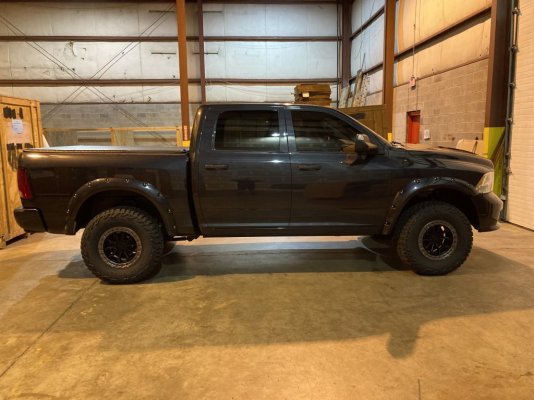

Lots of helpful members here that have more knowledge/experience than I do, but most recommend that you level with struts versus using spacers.
