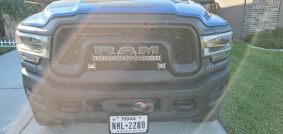

Is anyone else having issues with front sensors needing wiping all the time?
Issue is they are clean!
