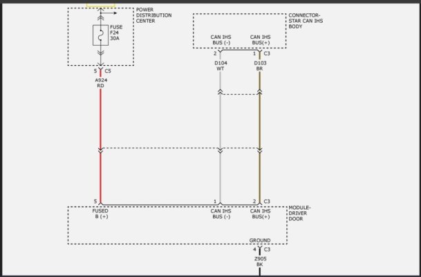

Check the other ends of the wiring harness connected to the driver's door module (DDM).
The drawing below is from page 1415 with more troubleshooting tips after, in the 2013-2016 service manual.
By R&R the DDM-side connector, that would technically reset the module by toggling the B+, but also would re-establish the IHS CAN bus signal. If the other end of the connection has a fault, this could be the source of your grief.
Download the PDF to a PC and word search using 'Control F'. I searched DDM.

So I believe I have a short in the light on the drivers mirror. I’ve left the harness for the mirrors unplugged form the module and the windows have worked great for the last 2.5 days. Crossing our fingers. Thanks for all the help guys
