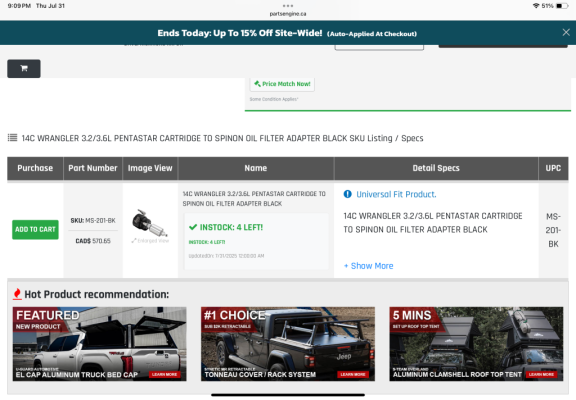

$570 plus tax and shipping for that piece of jewelry, here. I’m not a part of the Just Empty Every Pocket crowd so I’ve never bothered with this.
Also, there’s no chinesium copies that I can find. If China doesn’t copy it, do you really have a product worth selling?

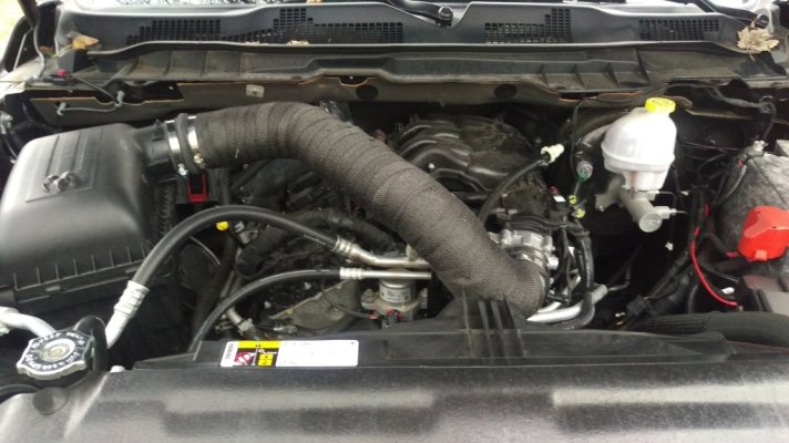

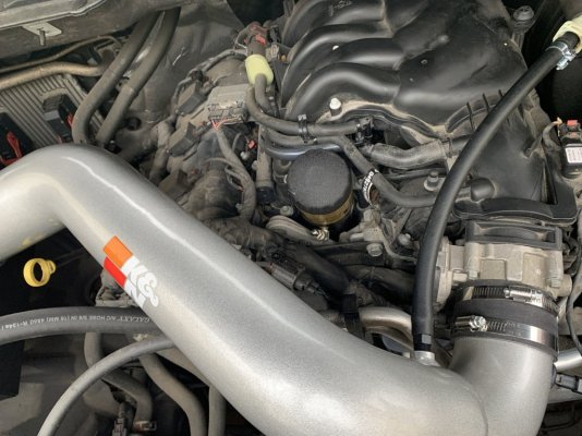

Installed the Baxter oil filter adapter at 33,864 kms. which is about 15,000 Km ago, because I was starting to get an intermittent tick while running and a regular rattle on start up. The Baxter adapter has a good anti drain back valve built in and if you buy the right spin on filter the filter itself will also have an anti drain back valve so you are double protected.
The cost is outrageously high $654 to my house here in Canada, but weighed against the cost of an engine repair I went for it.

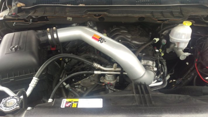

One drawback is the Baxter filter location is underneath the cold air intake cover which has to be removed to change the filter and doesn't allow room for a longer filter body.
I solved that by installing a K&N cold air intake system but that option is pricey as well at $619 to my door. I'm sure these items would be cheaper south of the border.
Cold start rattle and intermittent engine tick are gone, and I can now use a longer spin on oil filter with more filter media. The cold air intake has quite a loud roar when you put your foot into the throttle if you're into that sort of thing as well.
Both of these upgrades are easy to do if you're handy and willing to part with the cash.
One other note is that I waited for the extended warranty to run out before I did these upgrades, so there would be no issue with Mopar if a problem should arise.
My 2019 now has about 48,000 kms on it and it sounds better on start up than the day I drove her home. Smooth as silk.

Thanks sitkneelbend but myself and even the wifey likes the new louder engine sound. That's not why I bought it, but it sounds much more aggressive than the stock unit. Looks OK too.
I'm also hopping with the stock cold air tube removed the engine and oil filter area will run a bit cooler as well. A cooler oil filter base should reduce the chance of breakage and leaks as well. On my last oil filter change before the K&N install the Fram filter got hot enough to blister the non slip paint on the oil filter so this assembly sees some serious heat. I will see if this upgrade helps in keeping the filter cooler when I do the next oil change in the spring.
