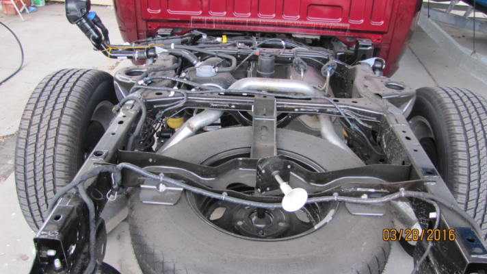

Gen 4 1500, temporary spare tire
Move the exhaust & dump it before the Rear Right Tire
That would give you at least 3" near the Axle Housing
Then modify the tire rack that holds the tire in place from below
