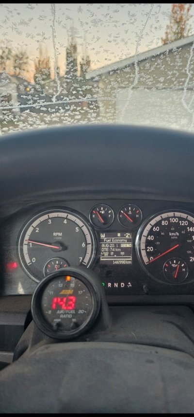

that is about what I get in town, and while I don't floor the peddle, I usally keep the tack close to 1500-2K on short trips .
Summer time on flat HI way with no wind ( not the usual here) i have got 10 L/100km at 115-120km / 70mph or so. In town 30mph/50km
I have never checked with paper and calculator, and WTH its way better then the 2010 Winter time it changes quite a bit. Hemi /8 sp same gears.
