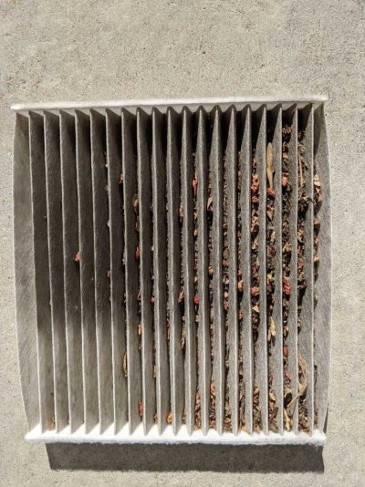

I would think any 2022 Ram 1500 would have them, regardless of trim level.
I did not realize my 2018 Big Horn had one until the spring of 2021. Pics:
