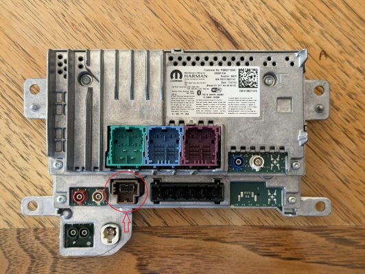

Sounds like you may a have defective media hub. I would try disconnecting the media hub from the radio, and see if the issue goes away. it will require for you to remove the screen. the radio module is behind the 12" display. you have to remove 2 crews from the top and pop the whole bezel out. some videos in Youtube can help you. I am attaching a picture of the radio module, and I circled the USB hub connection. be careful removing it, as it has a locking tab. I hope this help identify the issue.

If the problem component is likely the USB media hub, why not disconnect the media hub on the console end at the hub itself?
There are YouTube videos covering this for several different vintages of Ram trucks.
The console end is easy to R&R, and chances are that the hub has the fault anyway. I've removed the entire console box on my Warlock for a project before.
I will admit that I prefer to avoid disassembling the dash if there's any another solution. :cool:
