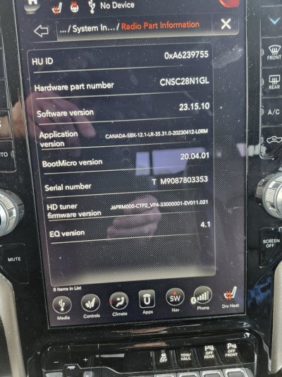

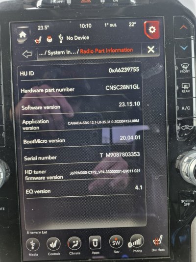

Curious at to what version software you have. Mine is CANADA-SBX-12.1-LR-35.31.0-20230412-LORM. I think I got an ota update a few months after I purchased it in fall of 2023, but can't remember for sure.

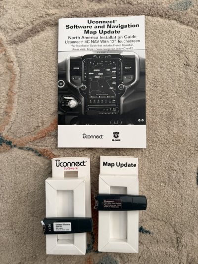

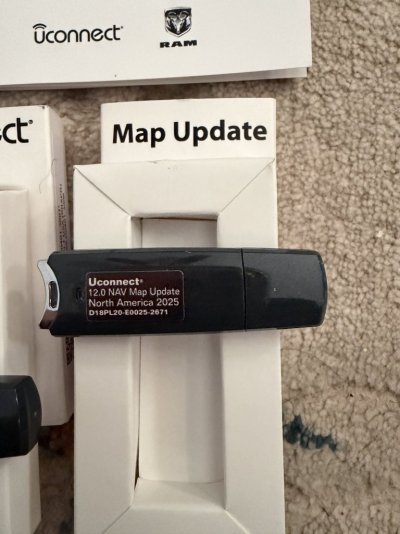

Here you go.
This is what I got when I ordered on 12 Jan 26 and all previous updates. These are updates for 2025. I check every year around Nov/Dec. It’s strange that it tells you there is no update when I have it right here in pics and installed in my truck. Since you have UC4 your updates come from the dealer or these USB sticks in pairs. I have never gotten an over the air update since I bought the truck and I pay for Sirius XM Guardian with Live Traffic and the Ram App for Remote Services.

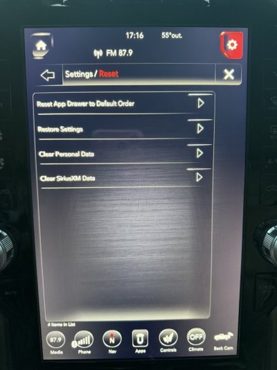

Here is a screenshot of my system info screen and what options you have for resetting your system. Hope this helps.

Thank you. Strange that your 40.1 revision has an older date than my 35.31 version. Maybe be rollout came later for canadian vehicles. I'll hunt around and see if i can find a Canucks version of 40.1, otherwise a trip to the stealership
