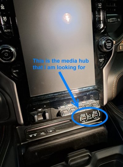

On my 2019 Laramie Longhorn 5th Gen with Uconnect 12" Harmon Kardon system, I spilled a few drops of coffee onto a USB port. Didn't think much of it until the next day, and now getting error messages. I want to replace that media hub shown in pic below. Trying to find the part is a challenge. I've been looking in a couple of Mopar sites, but they seem to be showing only the hubs for the rear seat passengers.
Can anyone point me in the right direction? Thanks
Here's a pic of my setup:

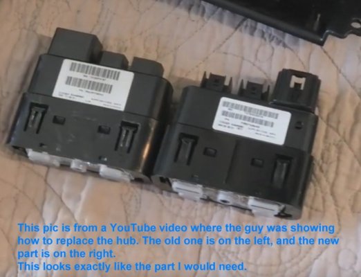

I watched a YouTube vid about replacing the media hub, and it's not a bad job at all, so I think I'm just gonna buy the part and replace.
@Dredger - thanks for finding that link. I will await a reply from Benny...

Damn, I'm impressed. I actually did go to that site, but I couldn't find it at all. That does look like the one I need and hopefully Benny @AllMoparParts.com can chime in and confirm that's the correct part.
Benny is that the correct part for me?? Many thanks, Dave F.
Hi,
Can you send me your VIN please, I see 2 options that look identical
Thanks,
- Benny

Hi,
Thanks,
- Benny
Benny, thanks very much for checking.
Here it is: 1C6SRFKT1KN567081
Regards, Dave F.

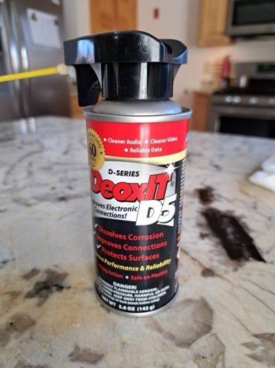

Yeah, I agree. I ordered the new one already. But a few days ago, I ran into this product (pic below) that was on my garage shelf. I forgot I had it. I put a couple of short spritzes into that USB port, waited overnight, then tried it, and I've had zero issues since spraying the 'Deoxit' in there...... :waytogo:

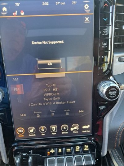

Well, my DeoxIT fix lasted almost two weeks, then that error message came back (pic below). It was most annoying, as it was on the screen all the time. No matter what app you selected, that error message was parked right there at the top, I couldn't clear the message for more than a few seconds, it would pop right back up there.
So I ended up installing the new hub from Benny today. I took the whole console right out of the vehicle. It wasn't a bad job at all. Now that big screen works just fine.... :waytogo:
