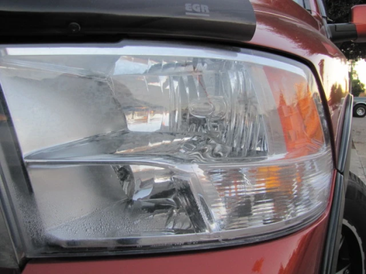

My truck is a 22 Ram regular cab short bed 2wd with a hemi. The truck has 13 k miles on it. The 3 year 36k warranty expires May 10th. It’s going to the dealer tomorrow for some minor issues. I would love to get some feed back from you guys what might be the problem/ solutions. First problem is the headlights get a little moisture inside and also get dusty on the inside. The dust is very noticeable at night with the headlights on. Not really noticeable during the day because they are the factory blacked headlights. Will the dealer replace these without me arguing with them?

As to your headlights. Do they function? If so, water or dust inside do not affect operation therefore they are working as designed. They will probably not help you.

Maybe it’s just me, but I don’t see how water intrusion into a sealed headlight can not be covered by warranty. Dust inside headlight? Can’t see how warranty can be denied.
If the headlight comes on, it's functioning as designed. Water or dust is not imParing function.
I fought this issue for about 6 months with dealer on my black projector headlight on the passenger side of my 2016 1500. And my home town dealer is a reasonable dealer. They would not consider warranty claim.
Finally just purchased a OEM replacement on ebay and changed it out. Sold the one with water intrusion on ebay. Clearly listed with evidence of water intrusion for about $50 less than I paid.
It was a time thing for me. I just didn't have the time to continue beating my head against the wall.
Any time over 12/12K is most likely going to be denied when it come to lights/bulbs

A faulty seal is a defect in workmanship. The housing should be covered under the 3year 36000 mile warranty. Light bulbs are covered for a year. That’s the way it worked on my 2011.

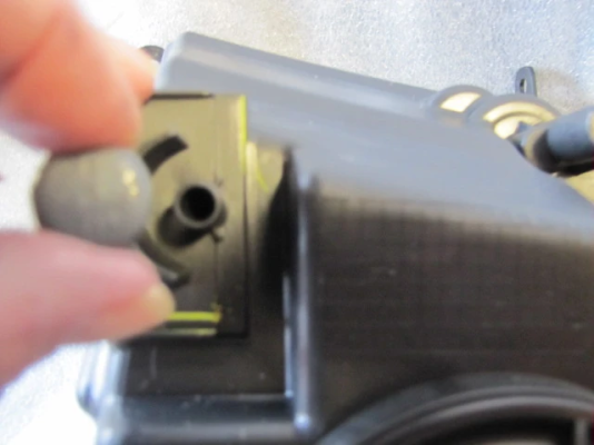

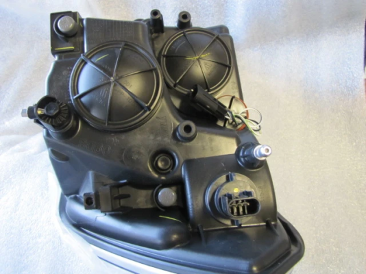

Someone may have handled the headlights
When handling headlights, you can change the VENT Settings
then you can get moisture inside the light housing
i think that i have a image from my last Ram
the GREY caps are vents
I pulled this cover off, to see what is under it
seems fishy
