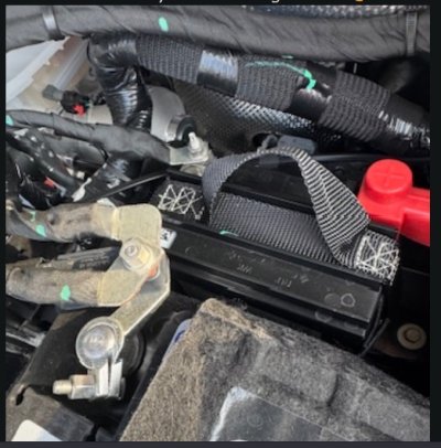

The 12.4VDC is the resting battery state of charge. The 14.4VDC is the alternator voltage.
With the start/stop feature, you also have a second battery.
From what I've read, the smaller battery behind the main battery is for the start/stop function.
If the EVIC displays that the start/stop isn't available, that's likely because the battery is not sufficiently charged or defective. I wouldn't be in a hurry to fix the feature, but I detest the start/stop concept.
