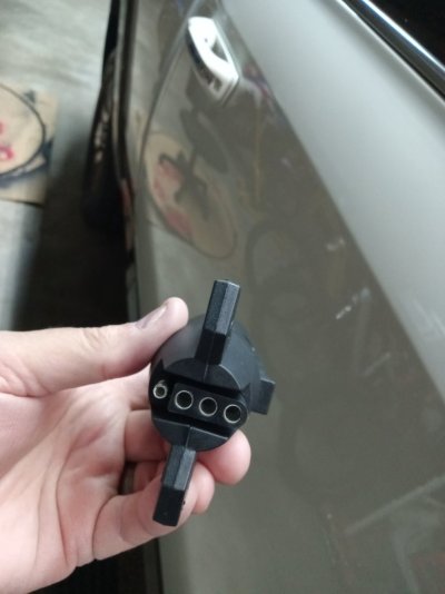

I have a 2026 3500 with the full tow package and prep. I have all of the latest and greatest trailer connections but can't seem to find a 4-pin flat connector. I've searched for it where chatGPT said it might be but can't find it. I was hoping someone on the forum would know if there is one or not.

Negative. If your 7 way port is paired with the 12 pin camera on the HD trucks then you loose 4 pin. This of course is if you only have one 7 way on the bumper. There is a traditional 7/4 one that ram tee'd off with the 12/7 like how my truck came so you may be able to invest in an oem option or just use a 7 to 4 adapter.
ai is not reliable...
post a pic of your bumper and we can see exactly which plugs exist.

It has no 4 pin flat connector. I use the 7-4 adapter, but have put a 7 pin plug on my utility trailer wired as a 4 pin so no need for the adapter.

My 2021 3500 has both 7 pin and 4 pin. The 4 pin is underneath the 7 pin. Surprised Ram doesn’t offer that anymore. Post a pic of yours.

On my 2022, There is no 4-pin connection point. I just use the adaptor. I have the factory 4 pin connector on my chrysler minvan, and that spring loaded weather proof lid on that connection, is so strong it bends the connector to point of damaging it anyway.
