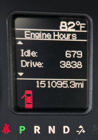

2015, 151095.3 miles, 679 Idle hours, 3838 Drive hours, no ticks, no adjustments. 20250505_162533063_iOS.jpg

Seems like 15-20% of total is appropriate for idle time for 5.7. Yours at closer to 50% is excessive.
On a diesel engine not so much an issue.
