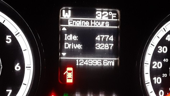

So as you can see my idle time is twice my drive time. This truck is from Canada and I am guessing the previous owner(s) were hunters and or campers as it has a roof rack, lift, and big tires (35s). I read the buildsheet and the buyer added a block heater and extra insulation everywhere. When I bought the truck in August it had a nice knock for a minute or two but the truck had been sitting for months at the dealer. I changed the oil to 5w30 and I only have a faint knock that you can hear if you are next to the wheel well this goes away after a few minutes and is only on a cold start. Should I be worried? Is a set of cams/lifters in my future or is this screen wrong? Truck is a 2018 1500 Outdoorsman with the 5.7.
**EDIT** After doing math these numbers can't be right. I would have to be driving 230mph to get the drive hours. I mean it might be possible. Maybe superspeed is hidden in a menu somewhere. So is there a way to view the actual idle/drive hours? I have OBD Jscan.

One possible scenario is that the cluster was replaced and the mileage was added from old one but hours represent total since replacement

I would put ZERO faith in the idle & drive time hour meters on our vehicles.
My (then) 19' which I purchased new in 19' had numerous instances where the EVIC displayed completely preposterous numbers that switched from high idling and low driving, to low idling and high driving hours.

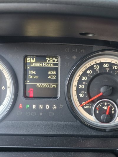

I pulled the real hours and they are:
Idle: 838
Drive: 3457
So better but still over the 20%. I'll continue to follow the advice here and run good oil and try not to remote start unless it is really cold out. I'll be doing a tuneup next year as well as it's 100k maintenance. The carfax and repair paperwork I could find show the previous owner took care of the truck. Just lost their mind when doing lights as that was a nightmare to clean up...

Also, my idle/ drive hours, this was an ex fleet truck I bought with 106K on the clock.
Haven't looked at them lately. But I've seen several members mention that their drive hours randomly reset to zero. So I wouldn't put much faith in that display. Just drive and enjoy!

My suggestion would be to log the driving time manually to see if the cluster is reporting drive hours correctly. You could do the same for idle hours. You shouldn't need to do this for a long time to see a result.
I am being advised that it is possible that a PCM address has been corrupted causing a miss count.
