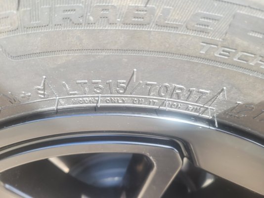

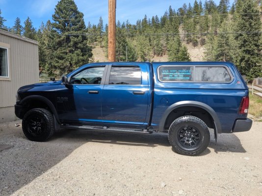

Here you go, 2024 Warlock 1500 Classic
315 70 17 on the stock platform. Stock 17 wheels. 17 x 8 +18 offset.
No lift kit. 10mm spacers which is .375 inch. Tires are 34.6 inches tall and 12.4 inches wide.
