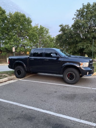

You would probably need to level/ lift the front to run 35’s, the offset & backing spacing can determine if you’ll have rubbing issues.
My original setup, just a level with 18”x9” + 1 offset & 35’s, ended up needing 1” wheel spacers due to rubbing on the uca’s.
Now I have 17”x9” -12 offset & 35’s, no rubbing or trimming required.
I do have 1.5” body lift currently but wouldn’t rub if I removed it.

I ended up going with bronze 17 inch zero offset method wheels. Hoping to fit 35's. I'll probably test fit the front first
