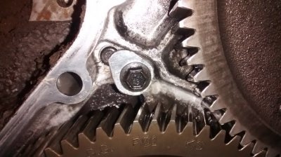

Just a little info on the 53 blocks for you guys. They do crack, because they're thinner and most people daily there diesel's cause they think it "cool to own one" and they never warm up. They develop hot spots because the t-stat never opens and then they get shut off and cool around these spots first. There is a reflash for the engine controller that reduces power until its at operating temp so it warms more evenly. I have had luck welding these cracks as well so a crack doesn't mean it needs a block.
On the kdp this is the fix I do to all that I work on. Grind a fender washer down cost $0.28
