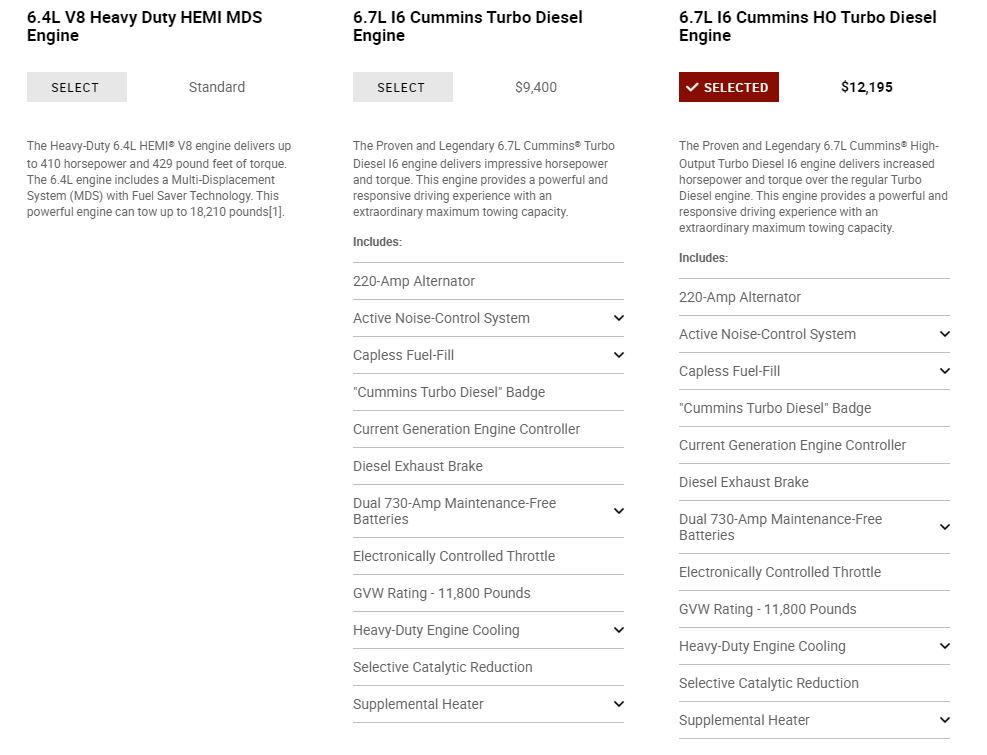

I see the engine you picked is the HO, but it appears the MDS has a higher towing capacity...did I read the right?
I also see you picked the 6 speed, why not the 8 speed for better fuel mileage...
Did not even occur to me to add air suspension....good idea, long trips on freeways pulling a trailer will knock your kidneys out...
The HO can't be mated to 8 speed (Warranty wise) only the Aisin is rated for the torque and is a HD trans (heavier) hence slightly less in towing however I've heard nothing but good from my friends that have them that they are just numbers and that you could tow a deasil locomotive up a grade if you had to
