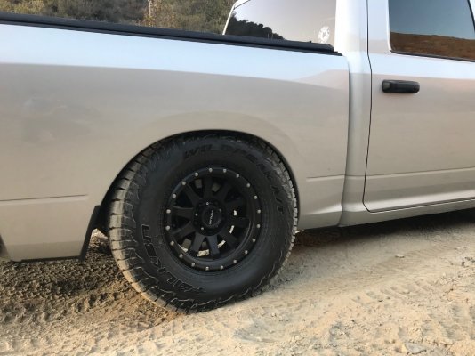

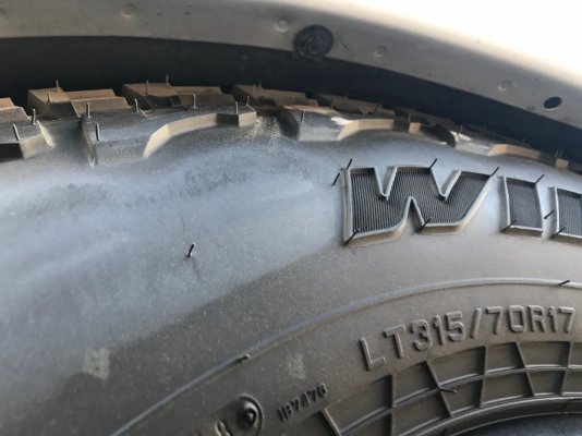

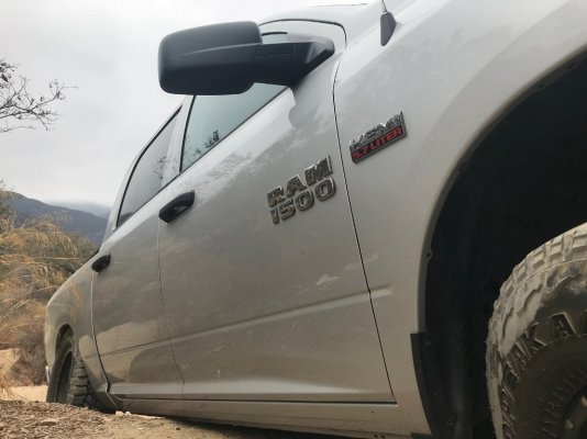

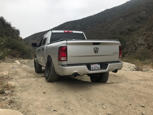

It'll rub only when one wheel tucks up in full as the tire angles up towards the liner while the opposite gets extended
This was on stock rear springs and Faken AT3W 315/70/17

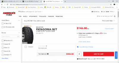

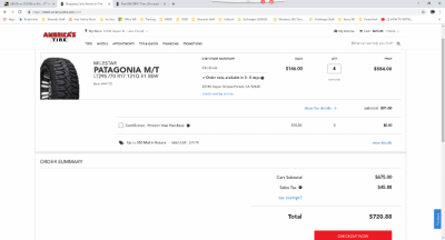

295/70/17 will have more tire options, the difference is minimal, and just FYI, the Patagonias in 295/70/17 are $146 each from discounttires right now... lol, they'll look good spaced out with those 1.5" wheel spacers you have.
$212 in 315/70/17
$233 in 37x12.5x17

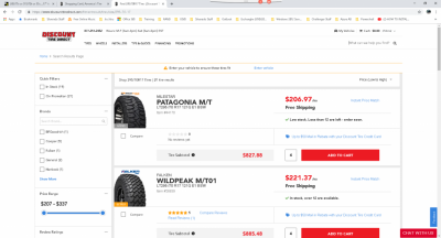

Btw, just checked and They are 200$? Each when I checked on the website. Wtf

But if i check with the Normal Discount site with my zip code, it shows $146
Maybe print this out and ask in one of your local Americas Tire stores and see if they honor the price, this is fraking deal right there
I will, if that's the price I'll buy them freaking today. Gotta find a local store
