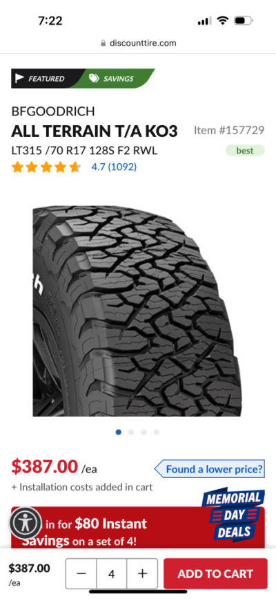

Thats the thing…35x12.5r17 d rated is $414, while the 315/70/17 f rated is $387.

Well then, I would just buy the cheaper version and not worry about it anymore.
