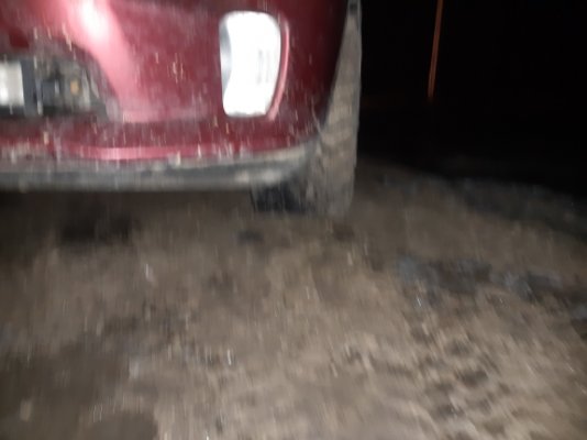

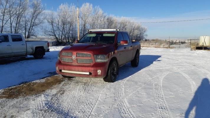

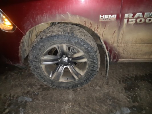

Sorry if they're a bit blurry.. Still dark here. 6ce82a96375604470f7de5f767c43114.jpg46e79f82fa043146f122977d97e69afb.jpg

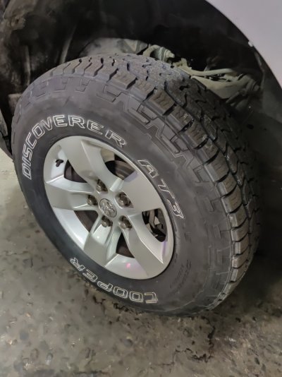

I second this. I was actually on the same dilemma a month ago (have the stock 17 x 7" wheels). I was going to pull the trigger on some 285/70 R17 Cooper Discoverer AT3 LT even though it's a bit wider but have seen a few Ram owners on this site using the same size without issues. They add about 1.2 inches tall compared to the stock 265s but they're 0.8" wider.
I ended up getting a set of Cooper AT3 4s in 255/75 R17. They're roughly the same height as the 275/70 but is a much more popular size so I ended up saving about $30 per tire.
If you want more sidewall without over stressing the stock wheel width, the best bet is a 255/80 R17 tire (a notch over 33"), but those are expensive and a bit hard to find.5eefd12867422ff82f26e6f65bd7f8f0.jpg

315/55r20 is what I was running before and they weren't bad. Only rubbed at full lock in reverse.
