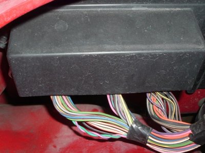

I cannot seem to locate a PCM for the tranmission, not sure if it has one
Mopar1973Man
Aug 22, 2011
825
21
New Meadows, Idaho
1996, 2002
1996 Dodge 1500 (V8-5.9L) & 2002 Dodge Ram 2500 (5.9L Cummins)
PCM is the little box on the passenger side of the firewall. This controls transmission, alternator, cruise control and a few other functions...
