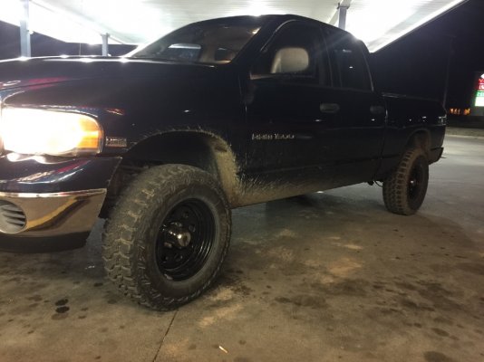

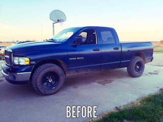

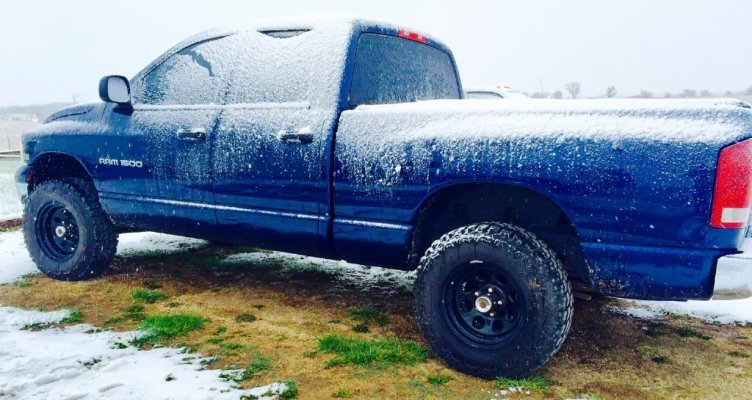

I had the leveling kit installed already. I bought the 3" lift spindles from Airbagit.com, they recommended the adjustable UCAs but I decided against it. I'm glad I did, it aligned out fine. In the rear I used the 2nd gen 2" lowering shackles which lift our trucks. If you do this your factory tail pipe will only clear by 1/2" to 1"
Here is mine on new 285/70r17s

Yes, 3" spindles, I left the leveling kit in as well. 2" spindles in the rear. 1f1faf75f5c5a54dcf6e86492b72d0bb.jpg

I will try get a pic on level concrete tomorrow to do it justice. It DEFINITELY stands proud compared to where it was

Cool I appreciate it . I'm gonna get the rough country 3 inch suspension lift and just trying to see what it will look like. I'm trying to compare the gaps to my truck but there's something wrong with my eyes lol I don't see that big of a difference. All I got is a level right now

You're welcome. Honestly, I installed the level 5 years ago. It was noticeable then but I think the springs have compressed since then. There is dramatic difference with the appearance and picking yourself up to get in with 3" spindles. Those pics at my house haven't done it justice
