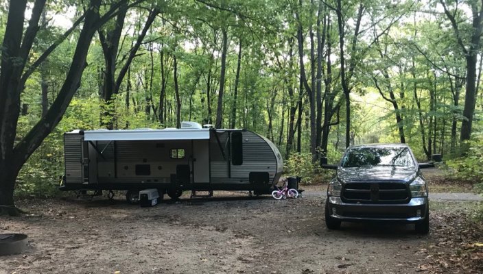

I know this thread has been around a while, but I wanted to add a positive experience.
Details: Truck: 2016 Big Horn 5.7 2wd w/3.21 gear, 8 speed XMSN. Bridgestone Dueler H/L Alenza tires. EAZ-Lift weight distribution hitch w/bar style sway bar. Camper: Flagstaff 27 RLWS, 6300 dry, 620 tongue, 32 feet long hitch ball to back bumper.
1800 mile trip from West TN to Chesapeake City, M.D. and back over Thanksgiving week.
I carefully set up the hitch based on instructions, videos, forums, etc. We also made sure not to overpack because I know how easily you can load up a camper. Hitch weight doesn't include 2 propane tanks and battery, so tongue weight is no issue. It actually was slightly smoother with water in the tank.
First day was 20-30 mph winds. Was able to do 60-63 mph comfortably. Slowed a little when trucks passed. The rest of the trip was 65-70 mph, occasionally topping 72. I honestly had no issues at all with the tow. Some sway was present, as expected, but nothing scary at all. I topped a hill once on the first day with a truck next to me and the anti sway kicked in unexpectedly, but no biggie. On the rest of the trip, speed was based on highway conditions. I-81and I-495 have some truck rutting that slowed us a bit.
The XMSN did great. I put it in Tow/Hawl and never messed with it. Smooth as glass. Temperature was pretty consistent around 195. Saw 203 in the mountains around Knoxville.
In case anyone is curious, we averaged 9.5 mpg.
I'll answer the obvious question before it's asked. I spend a lot of time on the road, so I wanted the Ram ride and the 3.21 mileage. We don't tow often. My best advice is to just be patient. You're not gonna anywhere fast with a camper. I'll get the recommended 2500 when I retire.
I'm a fan of the truck with the 3.21.
