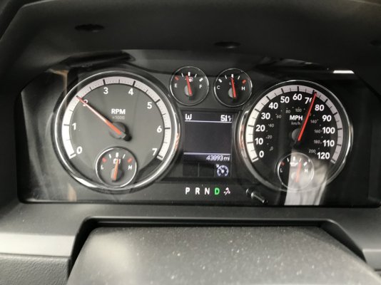

^ +All that. I love my 4.10s. But I can't help but wonder what could have been.
4.10s are a good all around gear for the 5/6 speed. They tow really well. Plus they don't rev all that high on the interstate.
I'll bet 4.56s are a hoot.
