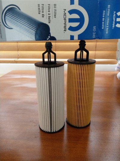

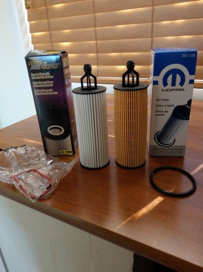

Finally found a Royal Purple filter for the 3.6L. I'll be using this on my next oil change. Looks pretty similar to the MOPAR filter. Its made in China (MOPAR doesn't say where their's is made on it).
I was only able to find it online at O'Reilly Auto Parts (shipped to my local store).765777a35accd82431e9488c674ce1e7.jpg

For the price, $17 after tax, I think I'll likely continue to buy the MOPAR 2 packs for $12. Unless someone else knows anything about the construction of these filters (like better filter media in one vs the other), these filters look pretty identical to me.

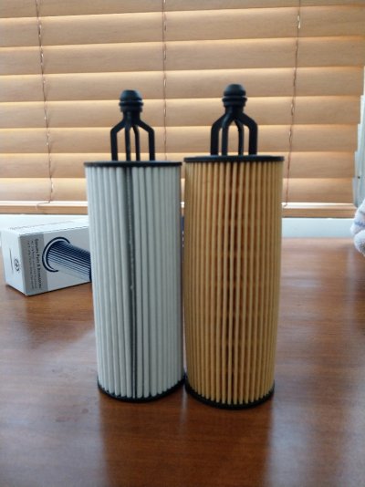

I noticed something in my pictures so I took a closer look. It appears the Royal Purple filter is slightly shorter...
Does anyone think this could cause a problem? I'm hesitant to use it if figment will be an issue.

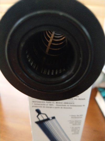

In addition, the Royal Purple's construction includes a metal wire mesh backing which is absent from the MOPAR filter.

yellow = paper
white = spun microglass
Spun Microglass not only filters better but filter longer, the binders used in paper turn filters into cardboard like structure usually around the 3 mos mark. Spun microglass use wire mesh to hold fibers together, paper filters use glue like binders after heat cycles stiffen up.
See oil filter thread for more.

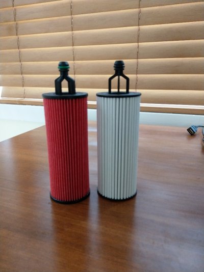

Good stuff, what about "light red" (AKA K&N)? I bought one to compare its height to the RP filter.f23cc13edd515597241a62b5fb7829b2.jpg

Unless they changed it kn is paper, maybe dyed red.
KN are experts at not giving relevant info on their products. They do make perhaps the best paper filters out there, but unless they have changed they don't make synthetic media. I hope they would, obviously it is desirable. We know fram uses pink synthetic, but I have no idea about the red. White is synthetic as far as I knew nobody has a white paper filter, famous last words.

Thanks! I only got the K&N to compare its height to the RP. I'll be returning the K&N to Amazon.

SitKneelBend: Interesting observation about the height difference. I too have noticed that some of the mopar filters come out with their pleats cockeyed. I'm wondering if they are getting 'crushed' to the correct length and the royal purple just dimentioned the length correctly. I've not seen it on any filters that I've replaced, but it is noticeable on youtube oil change videos. It could be true.
May I ask what caused you to use something other than mopar? The price is right and FCA can't blame the filter if there was an engine issue.
