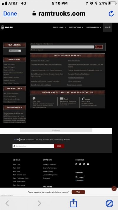

Where within this page am I to go? This is all that comes up.
Click on "Equipment list" in the left-hand column
Type in "VIN" where it says "VIN"
Click "Search"
Build sheet will list all options from the factory
Click "Search"
Thank you!!

Well after punching in the vin number of my own truck and the one I test-drove, mine has the 3.92 gear ratio and the one I drove at the dealer has the 3.21’s.
Maybe it’ll be alright and continue on with the same gears in my new truck...[emoji41]
