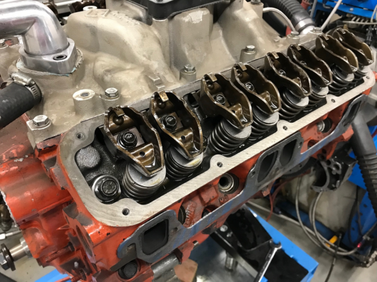

No, TBI is still LA, but it's LA with a roller cam. Magnum heads are more like SBC heads (no Mopar rocker shaft).
Screenshot 2025-06-13 at 08-50-50 valve-spring-upgrade-dodge-magnum-360-cam-swap-test.jpg (JPE...png
Oh yeah, I always forget about those
I'd love to have one some day...all the coolness of an LA, none of the headache of a flat tappet

'93. The 5.2 was the year before.
I think the AMC engineers were the ones behind the Magnum heads.When Mopar bought out AMC supposedly their engineers went with the package.I think the Magnum heads were very close copies of AMC's dogleg heads
