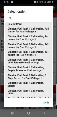

I didn't see it mentioned but what about recalibrating the gauge/sender using AlphaOBD?
So behind the scenes I've been on AlphaOBD checking the settings for the fuel gauge and tank. I don't think it had the correct capacity so I put in 121 liters. I set the full to 98% , LFW 8%, and empty 2%.
The remainder of the tank the 50 miles to empty came on and I kept driving errands for another 20+ miles. It then switched to 25 range. The next start up it just said LOW. At this time the gauge is on the lowest quarter of the red zone. I drove another 18 miles or so and the gauge showed empty so I filled up.
The tank took 31.35 gallons. This is the most I've ever put into it. Normally it would only take 26 gallons and once 29 to fill it. I think my gauge is finally operating to my liking. I'll know after this tank for sure since I'm starting full and for the full range.

Yes, I have a 32 gallon tank. Here's a screenshot of some of the parameters you can modify.

Theres a few threads on this matter which I have posted on about using AlphaOBD app to recalibrate the CLUSTER readings of the gauge to coincide with actual fuel level.
Like others my fuel light would come on @ 50 mile range. When I would fill it would only take 26. At most it took 29 and that was with the gauge on E hard for 25+ miles. My 2018 CTDHO truck has the 32 gal tank.
So I went into the Body module using ALPHAOBD and changed some settings. One thing was the capacity to 121 liters (32 g) . I also changed the Cluster Calibration percentage readings for FULL, LFW, & EMPTY to the highest for full, and lowest for empty and the LFW I think I set to 2 or 5%.
I ran a test initially after the recal. I filled the tank and ran it down to 1/4 tank on the gauge. Upon filling, from 1/4 to half it took 8.2 gallons. I continued to fill to half and it took another 8 gallons. The to full it took another 8. Since it's a 32 gallon tank it looked pretty promising my gauge is accurate.
Final test I ran it empty yesterday. the 50 mile range light came on with the needle in the red. I continued to run it until the needle was down to E and range wouldn't give miles anymore. I filled the tank yesterday morning and sure enough the pump clicked off at 31.7 gallons with me able to top it off with 32.2 gallons. I don't normally top off but I wanted to see how much more I could squeeze in.
Conclusion problem solved for me. I'm going to run this tank low again and see if it has the same results.
screenshot_20201221-162714_alfaobd-jpg.234440
