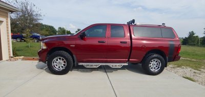

I have bils set at 2.8 and am running 35x12.50x18s on 18x9s with -12mm offset with no rubbing.
-24mm and 35s on a level I would think would rub because mine is very close at full turn
