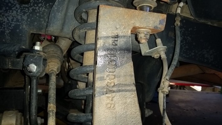

I'm not sure of the offset, but I had to run a 1/4 spacer on the fronts due to rubbing the knuckle. They'd rub at full lock for sure. I was running 33's for years, they needed replaced and I knew I was getting the lift. Told the wife I can replace the tires without the lift, but I can't put a lift on before replacing the tires lol.
Pay no attention to the ball joint, I was getting the struts replaced.

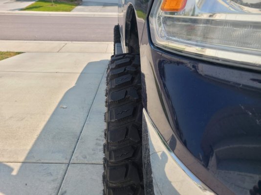

Adding to some examples, this is what 20x9 wheels with a -32mm offset on 37x12.5 tires looks like. This combo with a 6'' lift definitely rubbed the lower pinch welds and fender liners at and near full lock, which required some hammering and trimming.
