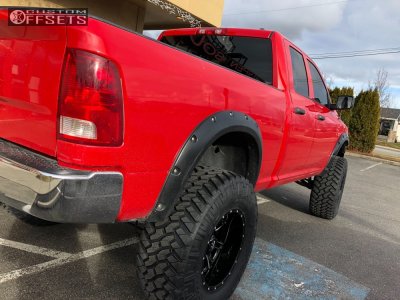

All 3 are running 20x12 -44
With 40x15.5 tires
White truck = 6” suspension with 3” body with no wheel spacers...minor metal trimming to make them fit
Black truck = cognito 12” lift and 1.5” wheel spacers...minor metal trimming to make them fit
Red truck = 6” suspension with 3” body with no whee spacers...has to trim pinch welds to get them to fit
