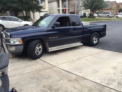

Not 2wd but a 2000 1500 5.9l gas.
Hope it helps in some way.
