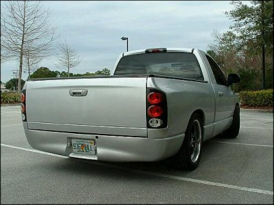

275/45/20 is perfect for a 3rd at 4/6, that's what I used on my old silver '02, sadly I only took a few when I went down to 5/7.5 then traded her in like a dummy.
Just my two pennies, the cheaper alternative to buying new, taller tires is of course going lower. Get some 2" drop shackles and cut a 1/2 of a coil off the front springs.
