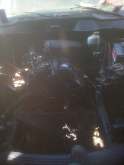

When u rebuilt your 4.7 did u bored it out? I'm asking because I am doing the same thing but I had it bored out an I gotten oversize pistons.now I'm looking to see if I should get different connect rods or does it even matter.the meantime I installed a 5.9l in my 05 ram1500 that had a 4.7. but I guess I was bored an now I'm taking it out an putting it in my 03 dakota...lol 05e95e88c6da3e3abbf063ac7381c135.jpg4b7d43df12e86808b1bba587b2fdc74d.jpg
I'd call you a glutton for punishment swapping engines left and right like that.
But to answer your question - no, I didn't bore it out. I just honed the cylinders is all. As far as connecting rods goes - are you building anything special or just doing a rebuild? If you aren't building for power then I don't see any reason to not just use the original rods, assuming they are in good shape.
Yes I want to pull as much power I can from that little beast..as for as punishment I don't mind it at all. It keep me from going crazy. My dad just pass away an my ex took my son from me again on his birthday on holloween.to put the icing on the cake .my two bros don't talk to me an it's been 15 years since we talk.i haven't gotten a good night sleep in years...**** I'm already putting the engine in my dakota ..
