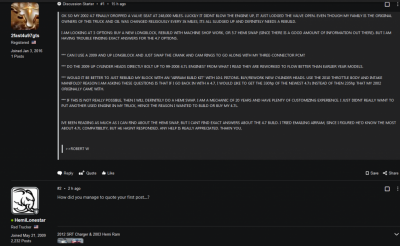

The original post on this thread:
The EXACT same post under your screen name:
