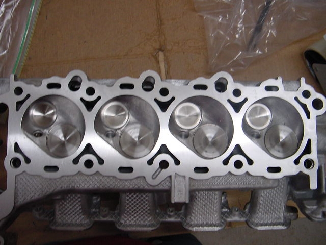

Not to much can be done to improve the 4.7 power wise just make sure you do a timing kit oil pump and stem seals thats the main issues with these engines.
also if you wind up needing cylinder heads let me know I do have a set of rare HO heads for a 4.7 will give you a few more HP. Im about to list a hoard of hemi heads 4.7 and 3.7 heads on ebay.

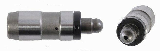

Hi, I researched the link that you provided and nowhere does it show a cam , pistons, rods etc for a 4.7 dodge !
You sure as hell didn't search very hard then,i found all these within about 2 minutes,maybe you should go back and look again,a little harder this time around ;)
