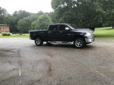

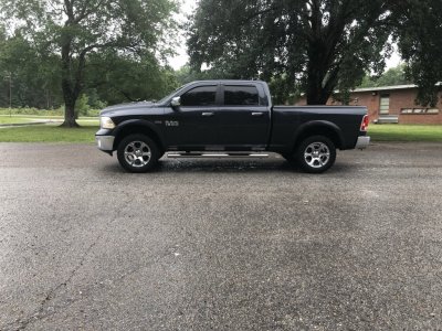

And here is with the 4" lift and Bils:
img_3795-jpg.165732
img_3799-jpg.165733
It started pouring rain right after I took those pics, so I will try to get some of the CV angles, etc tomorrow. The angles are kind of steep, but I don't think they're just awful.

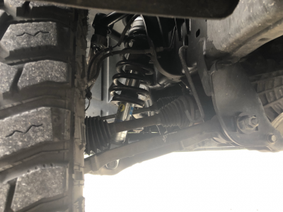

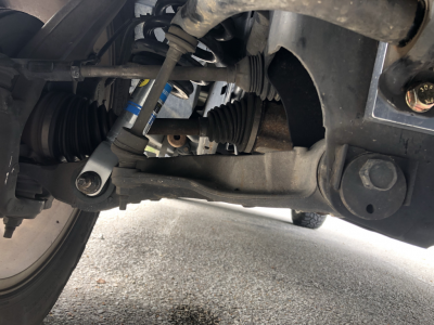

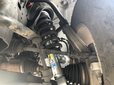

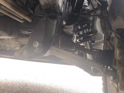

Here is a pic of the passenger side CV angle. It's definitely at an angle, but with this being my first 4x4 truck, I have no idea what too steep of an angle would look like. How does this compare to what yours are at?
roadrnnr
Mar 6, 2012
329
155
Vermont
Can you get some more shots?
Mine is a 2011 and they lowered the diffs in 2012 but still I have a feeling mine will be better doing it your way

Tha'ts Great Thanks. It's funny in a couple pics your inner one looks the same as mine but your outer one looks alot better.
You have any vibration in 4WD?
