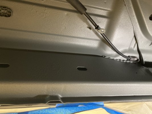

Step two: Raptor bedliner under the cab, covering the area between the pinch welds inward to the frame rails.
As an aside, do you know the factory just covers all those big holes in your rockers with cheap fabric tape? Guaranteed to fail and let mud and water spray inside. I'll be covering those with Eternabond tape.

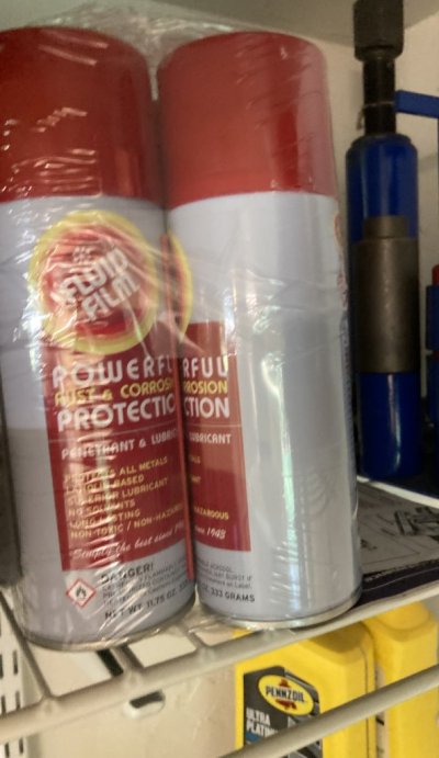

Step four: after all my mods that require getting under the truck and wrenching or wiring are done, I'll hose this inside the frame, in the body voids, and underneath in all the nooks and crannies. You don't want to do this until last, because until it tacks up, it's a slimy mess. And even when it does tack, it'll be greasy. But greasy > rusty.

Thanks for mentioning that, I do FF all the fender and body cavities. I use a flex hose with a 360 nozzle that can be insert into all the hidden spaces. Definitely including above all the fender liners.
For the exposed areas, I also have some WoolWax in black and clear. Might use some of that too. It’s tackier than FF.
