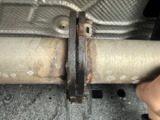

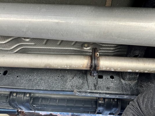

I'm having a similar issue with my 21' ram 1500 5.7 hemi larimeee crew cab. 41k miles. Noticed an exhaust leak and tried to tighten the bolt at the flange that had backed out and it snapped. Any idea if this would be covered, or any easy fix besides drilling the bolt out? I'm guessing the other will snap too. ex1.jpgex2.jpgex2.jpg

I don't think it'll be covered since it's post emissions systems, and you're out of warranty. You can try hitting the flange with a torch and using vice grips on what's sticking out, thread it through the rest of the way. Or take it to an exhaust shop and let them deal with it.
