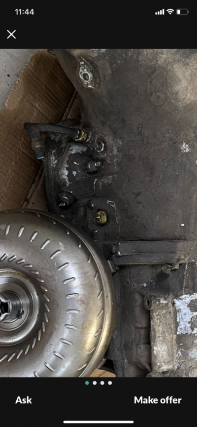

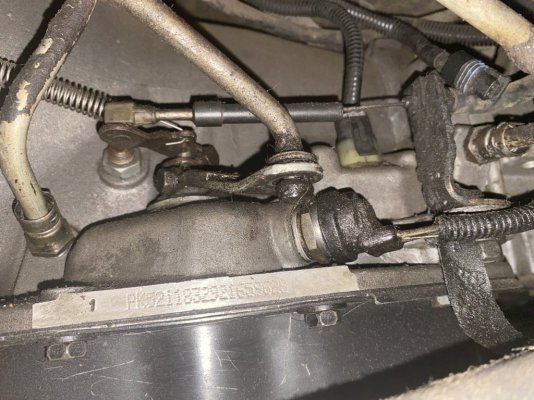

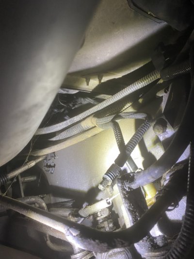

Had my truck tested and they found P0713, and a 2 wire terminal branched off a wire loom,along with the 3wire terminal which connects just above the neutral/start backup light switch,hanging left side of trans(under driver side).
They mentioned”trans temp voltage high trace circuit found wire out and no sensor at trans possible wrong trans, recommend replacing cam/crank sensor”.
I havnt found any resources referencing this cable , I have some pics I’d look to share hoping someone can ID it.
One of the pics is an ad where I noticed oil cooler line looks to have a sensor stem and terminal. I don’t have that on mine from pics you can see. Thanks for any help
