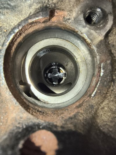

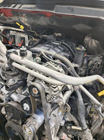

got a question . I removed the MDS solenoids at the bottom of the bore are plastic inserts with little magnets do those stay or go with the delete kit don't know if they affect the flow of oil . oh wise ones please advise

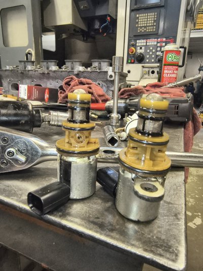

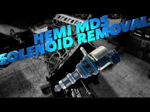

Here is a video explaining it pretty clearly. Not uncommon to "break" the solenoid and leave a piece inside that has to be removed.
That magnet piece should have come out with the solenoid.

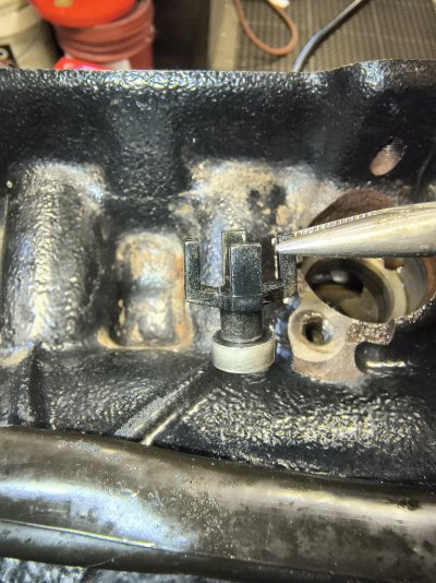

they came out fine looked in bore saw black plastic pulled out with needle nose . so they are part of solenoid ?

they looked like they were separate to catch fine metal particles.

yes. the parts I'm talking in picture above sit's in the bore under the solenoid

I'm assuming the oil flows over it and the magnet catches any metal in oil it's a 2022 motor. but you know how assuming can go:oops:

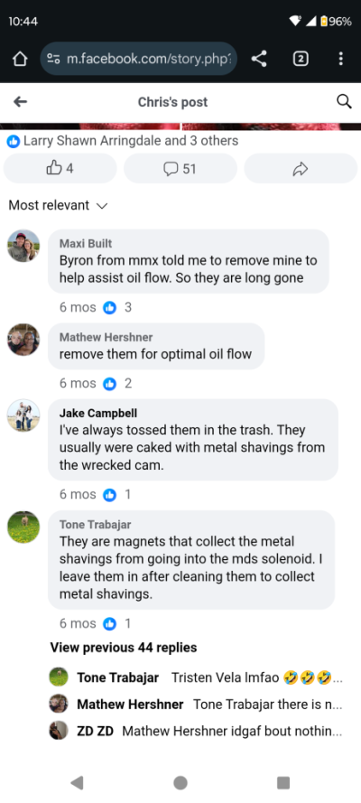

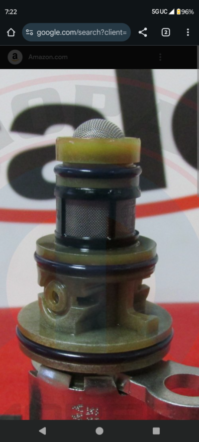

So do any of you guy's know if those little magnets stay or go1754313375320.png1754313375320.png

I did a couple google searches. This is the closest to a definitive answer I could find.

Well, they are only in the MDS circuit oil passages. If the MDS solenoid is deleted, then there seems to be little use for them (the other 4 circuits don't have them from the get go). Plus they will be basically just sitting in the oil passage with only a magnet holding in place after the solenoid is deleted.. Don't think that is optimal and they "could" move / migrate where they shouldn't be, perhaps.
Bring them to the pond to do a float test.

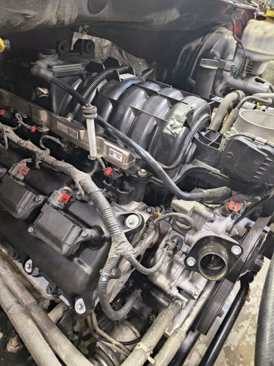

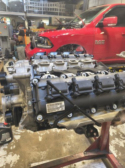

Buttoned up and going in tomorrow

Looks very clean. I would probably put something over the plug to keep moisture out.

I'm inside and covered the intake ports for install after pic . this is where I'm at now
