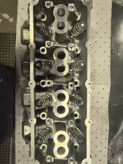

yes oil pan is off I have more time to work on it now new pics lobes starting to flake for sure

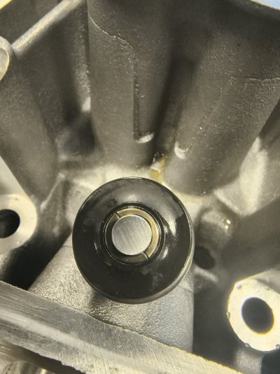

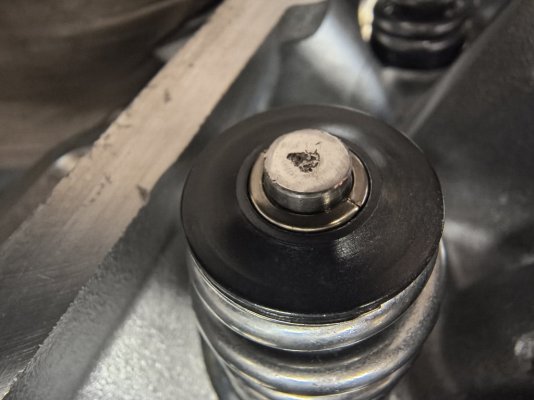

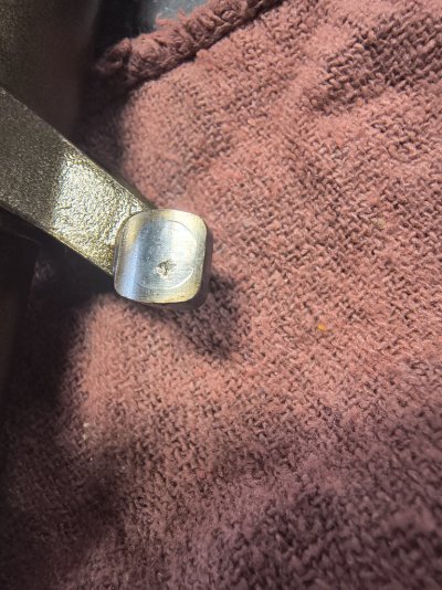

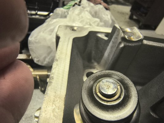

well got the parts in for cam swap of course more issues look at top of valves and one pic of rocker arm pitting in center and edge . has anyone dealt with this i can use a surface grinder to remove but don't know allowable tolerance.

so taking my 260000 mile 5.7 apart intake lobe wiped the retainer yoke for lifters very loose will not hold lifter any more look's to me that the lifter turned in bore. because of radius on cam

I'm surprised those are off 47,000 mile motor i put the valves in a v block and checked squareness three were not square at all so I checked the worn ones were .008 thou longer than rest so I dusted the top of all of them and deburred the edge's 7 of them were razor sharp from the get go . they are all well within the factory spec and square now . replacing 4 rocker arms

Wow! I've seen a number of 5.7s apart and on some the valve components looked better than those at 150,000+ miles. What kind of lubrication strategy are you using?

this is from a motor I picked up to put in my ram , I don't think the previous owner cared about the oil. my engine had 260000 on it and yes it look's better . it all good now . decided on small mmx cam mds delete fresh oil pump and throwing a 8speed in it in a few months . I see a lot of people like the redline and purple filter . I think ill try it . not sure guess I should figure it out don't know what the overall best product for these 5.7s is
